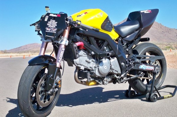

UNREAD_POSTpor SBK RACER » 03 Oct 2013
Tengo un listado pero es en Ingles... Muchas de las partes no se como se llaman en Español... :-D
ACCESSORIES
Kosso Instrument Cluster
Frame Sliders
Sub Frame Sliders
Aluminum Fuel Tank Bracket with Pro Bolt Blue Titanium Bolts
Aluminum Swing Arm Spools, w/ Pro Bolt Blue Titanium Bolts
Pro Bolt Blue Titanium Bolts in Many Places...
Billet Aluminum Gas Cap
GSXR Kick Stand Machined to Fit
Custom Rear Fender Eliminator
BODYWORK
Eurobikes SV650 Race Belly Pan
Suzuki Accessory Seat Cowl
3M Scotchprint 1080 Carbon Fiber Warp Film
BRAKES
Beringer 20.6x14 Billet Master Cylinder
Brembo 320 mm Rotors
Pro Bolt Blue Titanium Rotor Bolts for Brembo Rotors
2009 GSXR1000 Mono-block Brake Calipers
TWF Racing 5 mm Caliper Spacers
Pro Bolt Titanium Caliper Mounting Bolts
Pro Bolt Blue Titanium Front and Rear Caliper Hardware Kit
Red Anodized Aluminum Banjo Bolts
Galfer GP Stainless Steel Brake Lines Front
Galfer Gold Stainless Steel Brake Line Rear
GSXR Custom Ultralight Rear Rotor
Vesrah RJL17 Pads Front, and Rear
CONTROLS
Vortex Black Clip-Ons
R6 1/5 Turn Throttle Tube
Renthal Dual Compound Handle Grips
CRG Supersport Clutch Lever and Perch
Billet Aluminum Rear View Mirror
Vortex Black Adjustable Billet Rearsets
Dynojet Quick Shifter, GP Shift
DRIVE
520 Sprocket Conversion 15/46
RK 520 X Ring Gold Chain
Renthal Ultralight Marchesini Rear Sprocket
ENGINE
SV1000S Snorkel
BMC Race Air Filter
Factory Pro Velocity Stacks
PAIR Valve Removal
Dynojet PC USB III / Custom Dyno Map
TRE Switch Modification
TWF Racing Bored Out Throttle Bodies
1999-02 SV650 Intake Cam Swap
Leo Vince High Mount Full System
Barnett Race Clutch, Friction Plates, and Heavy Duty Springs
Silicone Water Hose Kit
ELECTRIC SYSTEM
Maviryk MDA123 8 Cell Battery
2010 Honda CBR1000RR Regulator Rectifier
Rear Brake Light Flasher
SUSPENSION
2008 GSXR 1000 Front End conversion Triples, Forks and Axle
Traxxion Dynamics AK20 Race Internals
0.95 kg/mm Fork Springs
Traxxion Dynamics Top Out Springs for Increased Travel
Pro Bolt Blue Titanium Front Axle Bolts
Pro Bolt Blue Titanium Forks Pinch Bolts
Penske 8983 Double Click Rear Shock
Hyperco 525 lbs/inch Rear Shock Spring
Aluminum Suspension Links
GPR V4 - 20 Click Stabilizer
WHEELS and TIRES
Marchesini Forged Aluminum 3.5x17 Front Wheel
Bridgeport 83 degree Aluminum Valve Stem
Front 120/70ZR17 Pirelli Supercorsa SC2
Marchesini Forged Aluminum 5.5x17 Rear Wheel
Rear 180/55ZR17 Pirelli Supercorsa SC2

Bienvenido al foro, se ve que tu SV es muy wapa y le has caido bien al inquisidor, ya que no te ha dado una colleja y te ha mandado al subforo correcto para la presentación...Haschi espavila que esto se desordena por momentos :carcajada:
Re: Hola, Nuevo en el Foro, pero no para la SV650...
UNREAD_POSTpor HaScHi » 04 Oct 2013
enricsv escribió:Bienvenido al foro, se ve que tu SV es muy wapa y le has caido bien al inquisidor, ya que no te ha dado una colleja y te ha mandado al subforo correcto para la presentación...Haschi espavila que esto se desordena por momentos :carcajada:
Dilo claramente, no vayas insinuando como una ramera adolescente.

Gracias! ...Pero es la motocicleta la fantastica... Yo aprendi preguntando y leyendo...
Hay libros tan tecnicos que no los entiendo... Como Motorcycle Dynamics (Second Edition) by Vittore Cossalter (Oct 2, 2006) Las figuras tienen trigonometria que aun no entiendio... El libro es buenisimo!!!
Otro libro muy bueno, Motorcycle Handling and Chassis Design: the art and science Paperback – January 1, 2006 by Tony Faole... Bastante tecnico pero mas facil de leer...

Bienvenido al foro! Increíble preparación de la moto, y muy bonita tu SV! (ya he visto las fotos que has colgado en otro post)

Alucinante, gente como tú hace falta en todo foro monomarca (y monomodelo como este caso). Bienvenido compañero, da gusto leerte :birras:

Me resisto a entrar pq me da miedo ver la lista de mods

Luis, acá serías el sueño de todo Guardia Civil de Tráfico o policía local o similar... si te pararan, igual no podrían multar de la emoción, no sabrían por donde empezar. En Europa no está bien visto modificar las motos y aún así nos las ingeniamos para ello. Si te multan por cambiar los escapes o pintar la moto!!!

Bienvenido.y vaya inversion de piezas en la moto....raro vender la gsxr y quedarte con la sv para pistear...
Ya solo le queda como dicen meter los kits de motor...
La sv del italiano es lo mejor que he visto. Tanto por preparacion, pq m gusta el chasis y las fibras. Y debe ir... O_O

Que chimba de moto.
Felicitaciones, un gran trabajo. Envidia de la buena.
